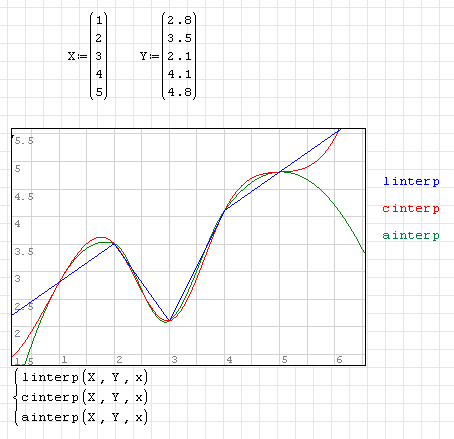

Here is an example showing these functions:
spline interpolation example
Notice how misleading all of these functions are outside the range of the original data points — that is, below x=1 and above x=5. Make sure you only use these for interpolation, not extrapolation.

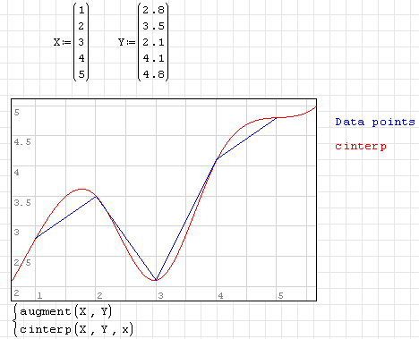

You can have the X-vector sorted in ascending order:

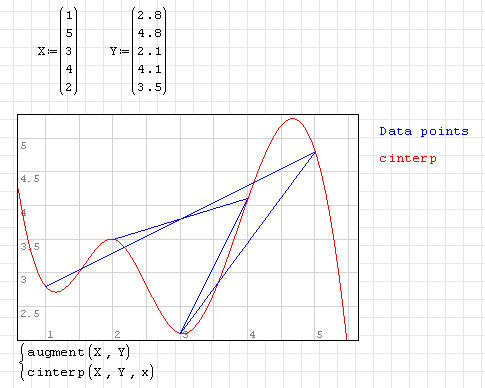

The X-vector can also be left unsorted. Since the main use of interpolation is to estimate a y-value for an x-value not in the table, this is not advisable:
X-vector left unsorted
