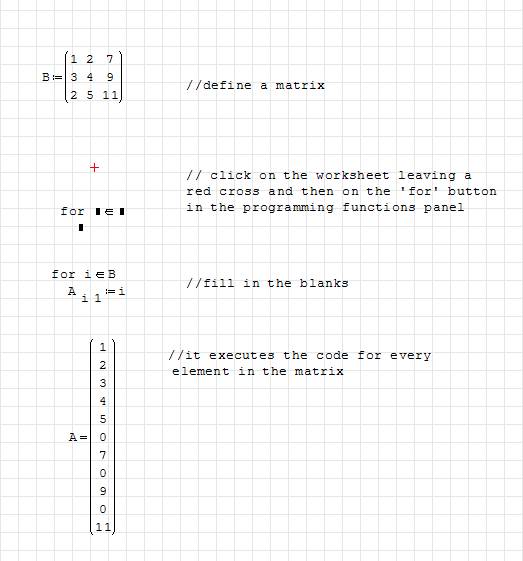

There are two forms of for. The first is the one that appears when you first press the for button. It steps the variable through each element of the matrix in the second argument. The ε sign means 'is an element of'
for loop iterating over matrix elements

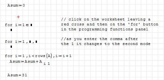

The second method is started the same way, but when you enter a comma the for line changes to the other mode.
for loop in counter form summing a matrix column
